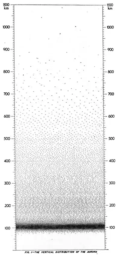

Auroras typically happen pretty high. About a century ago, Norwegian scientist triangulated more than 12,000 auroras, and this is the distribution they found:
Figure 1 from Störmer, 1946.
So the fist problem will be to "touch" anything at an elevation of 100 km, where the atmospheric pressure is 0.00006% of the sea level pressure and 0.0002% of the pressure at the top of Mount Everest (pressures estimated using CalcTool).

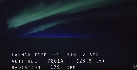

You might want to see this video of a weather balloon sent up under an aurora. With cameras and radiation sensors. It is pretty cool, but it only got about a fifth of the way towards the aurora. And you can't get much higher with balloons, the world record (unmanned) is 53 km, which is just half way there. These are a couple screenshot from that video:
