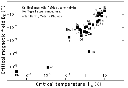

I live in The Netherlands and the meteorology institute published real time UV measurements (as UV index) at https://www.rivm.nl/Onderwerpen/Z/Zonkracht However the UV index is defined as the amount energy that is radiated on the flat surface of the earth. As we humans generally have more vertical surfaces, especially sensitive surfaces like the face, would it not make more sense to not just measure in the horizontal plane? Especially during the evening and the morning the sun is at a low angle, so the (relative) energy on a vertical plane would be a lot higher than the above graph suggests.
I made a small program that parses this image, and recalculates the UV index for the vertical plain (divide the UV index by the tangent of (90 degrees minus current zenith angle). This would be the output (blue line is vertical UV index): UV index in vertical plane

    Hello Fred, I did consider this, but this is already part of the/measurement of the horizontal plane (the base graph). I do not need to compensate for that again, when switching to the vertical plane (the blue line). – rogerwilco Jul 05 '18 at 15:56

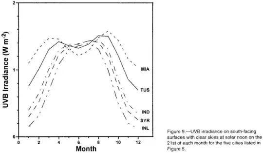

According to Ultraviolet Radiation, Human Health, and the Urban Forest it would seem at least the general shape you obtained is correct: UVB irradiance on south-facing surfaces with clear skies at solar noon on the 21st of each month for the five cities listed in figure 5
Here they tracked the irradiance at noon over different months of the year not hours of the day, but the basic change is the same: high to low to high Solar Zenith Angle when irradiating a vertical surface leads to an irradiance graph with 2 "shoulders" on both sides of the maximum solar elevation point. The irradiance is lower at the central point because the direct rays are parallel to the target surface and the only contribution are the scattered and reflected rays from the environment and the rest of the sky, and then as the SZA progresses more and more toward 90 degrees (or elevation toward 0 degrees) the increasing atmospheric absorbance comes into play and reduces the irradiation long before the rays become exactly perpendicular to the target surface.
But if the goal of the UV Index was to provide safety data for the general public, I would say it should've been measured assuming the absolute worst-case scenario of some unprotected skin being exposed to exactly perpendicular solar rays at any hour of the day (this is possible because our bodies have complex surfaces and it's always possible to have at least a little skin that's perpendicular to almost any ray direction in all of 3D space). So they should've used a detector that is rotated to face the sun at all hours of the day, and the resulting graph I suspect would not look like the official daily UV Index graph but also not like the "2 shoulders" one we have here. It would probably look more like the "IND", "SYR" and "INL" variants in the image above: a sort of "Gaussian with a wider top".

To answer my own question: the principle is sound however the calculation does not work out, because it assumes only direct UV radiation, and not the real-world scenario of scattered UV radiation.
