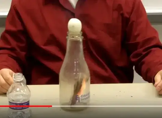

I was surprised at first by this result, but it nicely explain the classic experiment where a boiled egg get sucked into a bottle: enter image description here This is an screenshot of this video where you can see the trick in action (skip to minute 1:10)

    Pretty sure the egg-in-a-bottle effect happens because the burning paper produces HEAT and STEAM, both of which increase the pressure enough to force gases out of the bottle (by raising the egg and bubbling out around the contact ring). When combustion stops, the remaining air cools, the remaining steam condenses, and THAT reduces the pressure enough to suck the egg down. – jeffB Mar 12 '19 at 14:58
  • @jeffB That would make sense. I was surprised that the 0.6% volume reduction would be enough to suck the egg into the bottle. Although I'm not convinced on the role of condensation, but the temperature could easily be the main driver there. – Camilo Rada Mar 12 '19 at 22:44
