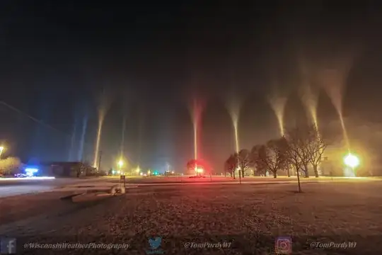

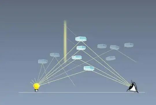

The answer can be found in The New York Times article Light Pillars, a Million-Mirror Optical Illusion on Winter Nights and in The Washington Post's Rare light pillars cast colorful columns into Wisconsin’s night sky says:
However, that’s just half the story. The formation of light pillars requires hexagonally shaped ice crystals in the air to reflect the light. Moreover, they have to be oriented horizontally, like flying discs or plates to bounce light back toward the observer. Less-organized orientations can produce sun pillars and halos.
A more physics-based explanation can be found in this answer to the question Are there measurements or calculations that suggest atmospheric ice plates would be horizontal to within 0.1 degrees?
also see Les Cowley's Atmospheric Optics page Sundog formation
