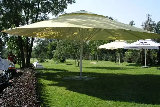

What will be the effect on a desert-like area if it is covered with millions of umbrella-like structures like the following one?
Would it play any positive role in reversing the desertification?

It would depend on the reflectivity of the material used - a lighter color will reflect more solar radiation and help cool an area fairly quickly , but it would take longer for the area covered with such structures to experience changes in poleward. energy transport. The poleward heat transport determines where the jet streams are located and how far north and south tropical rains (intertropical convergence zone) move. Thus, whilst the structures would cool the area, there would likely be insufficient rainfall to re-establish substantial plant life and reverse desertification.
In short, because of the need for water and the mesoscale weather patterns in a desert, shading the deserts would have little effect on the rate of desertification.

  • there would likely be insufficient rainfall to re-establish substantial plant life and reverse desertification. - is it because of the umbrellas? –  Jun 10 '18 at 08:39
  • No, because of how heat is transported from the equator poleward. The equator has surplus heat, which causes are to rise, condense, and rain, that same air then moves away from the equator (near the top of the troposphere) and as it does it cools, at which point it's as far north as about 10-20 degrees where it's lost enough heat energy that it sinks, sinking air doesn't condensate, thus, no rain, and there are semi-permanent areas of high pressure above deserts. That air sinking because it's cooled raises the pressure at the surface. This is shown in this diagram: https://bit.ly/2Jy5mOx – Phil C Jun 10 '18 at 22:44
