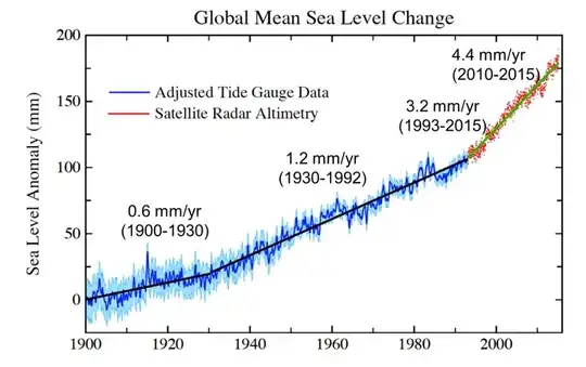

However, it is very important to highlight that "in average" part, because of the rates involved. Let's have a look at the sea level rise rates:
As you can see in the above image (taken from Hawaiʻi Climate Adaptation Portal), the rates of rise are in the order of 4 mm/yr, a value that is small in comparison with other processes that can also change elevations. When you go down to the millimeter-scale, the topography is much more dynamic than you would think, for example:
