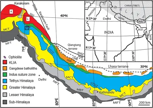

This geological map of the Himalayas shows in geen the outcrops of the Indus suture zone.
Taken from The Tethyan Himalayan detrital record shows that India–Asia terminal collision occurred by 54 Ma in the Western Himalaya
