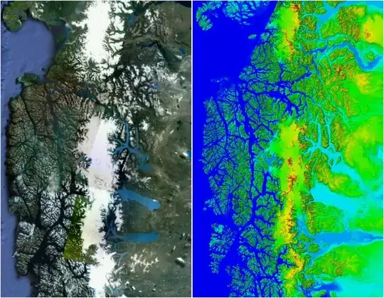

The following image show how the area looks from above, with a sat image on the left (where the ice extent is clear) and the topography on the right:

  • I work on orographic precipitation. Please clarify the scale of the system - mesoscale or synoptic. If mesoscale the physiography and topography will also play a role –  Feb 28 '18 at 00:52
  • You probably are considering a simple upward ascent model from that image. Even still is that slope barren or is there vegetation ? That will definitely affect the lapse rate. Also how do you want to tackle the lower boundary ? –  Feb 28 '18 at 01:43
  • @gansub I'm very glad to have your input here. I'll update the question with those details for the area of my greatest interest. – Camilo Rada Feb 28 '18 at 02:15
  • @gansub I've added a fair amount of info of my main area of interest. Have a look. I'm a glaciologist planing to work in that area and this question is of great interst to me. Thanks a lot! – Camilo Rada Feb 28 '18 at 06:31
  • great to know. What is the resolution of the elevation model ? You need to run a mesoscale model(1 km grid spacing) to get the answer that takes into consideration the topology(from the elevation model) and maybe land cover. The synoptic part will come from sort of PV analysis considering you are closer to the poles. The answer David has provided will be the simplest case. Since you are looking for a research answer the way forward will be to run a simulation with say WRF tuned for those conditions. I can write it up over the weekend –  Feb 28 '18 at 07:07
  • @gansub The resolution of the elevation model is 30m (SRTM), but it would be easy to downsample it to 1 km. I'm glad to hear you agree with DavidH for the simplest case. I look forward to your answer over the weekend. If you need any others details/data just let me know. And thanks again! – Camilo Rada Feb 28 '18 at 07:24
  • I'm glad to hear you guys are sorting out the details. I'm going to leave my answer for prosperity, but I agree with @gansub that it answers the simplest case. Good luck with the research! – DavidH Feb 28 '18 at 12:33

Examining two extreme cases, one very cold and the other very warm, the amount of precipitable water in the very cold one will be far less than that in the very warm one. Even fully saturated, the very cold air mass would need to be lifted quite high to form large enough ice crystals or water droplets to have enough mass to begin falling. Meanwhile, the warm air mass would produce larger droplets very quickly. Thus the warm air mass would begin to produce precipitation at a lower altitude, and with greater intensity.
Because the air masses begin precipitating at different altitudes, the point of maximum intensity would also be lower for the warm air mass.
