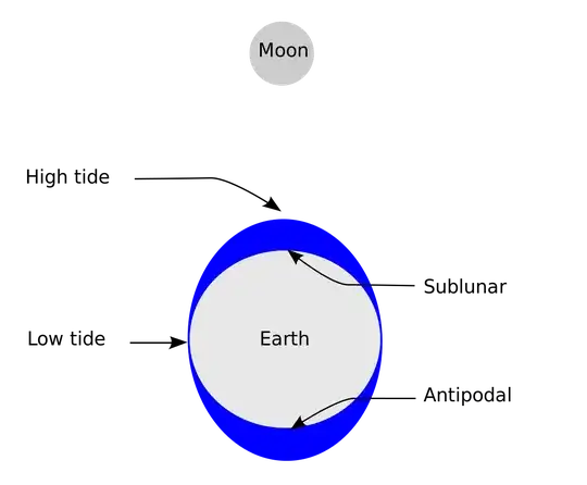

There are however processes at work today that are slowly stealing Earth's angular momentum. The most important one is tides. Tides produce bulges of water around Earth that rotate slower than Earth, as in this picture (from Wikipedia): enter image description here
Therefore, to keep the bulges in place the water have to be constantly flowing into those bulges moving against Earth's rotation and slowing it down by friction. The lost angular momentum goes mostly to the moon that accelerate on its orbit, therefore moving away from us 3.8 centimeters per year.
This process makes the day longer 1.7 milliseconds per century, something that is not a lot even at geological times scales. It is equivalent to 17 seconds per million of years. But even that small amount adds up to almost one full hour since the start of the Jurassic (201 Ma ago). But the change is so slow that animals would have plenty of time to adapt.
