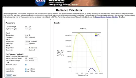

I am trying to graphically show the radiance emissions of both the Sun and Earth. I am using NASA's radiance calculator then going to graph it on paper.
Here is what I typed in:
Low wavelength: 0.1μm
high wavelength: 100.0μm
Plot 1:
Temp: 5778k <- for the sun's avg temp
Emissivity: 1.00 <- was unsure what this was for
Plot 2:
Temp: 274.03 <- for the Earth's avg temp
Emissivity:
x-axis scale: log
y-axis scale: log
Here is what that all looks like: enter image description here
As far as making a plot of the emitted energy of the Sun and the emitted energy of Earth on the same graph does this look correct? How might one annotate/label the curves to show where the peak emission occurs?
Should the x or y axis be dialed down they are between 0.1 to 100.0 and then the y-axis sale 0.01 to 10.000
I appears that the Suns peak emission is between 0.32 - 10.00microns and the Earth is 10.00microns.
Thank you

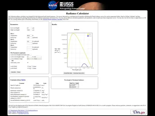

The graph looks correct, and after having a look at the NASA/USGS Radiance calculator, it seem that curves can't be annotated. However, below the plot there is a button to download the source data of the plot as a comma separated file (CSV), that you can open in Excel or any spreadsheet manager program and plot it with annotations and all the customization you want.
For the wavelength of the peak in emission you don't have to look further than the box below the graph titled "Wavelength of Maximum Radiance", which for the Sun should say something like 0.52 micrometers as in the screenshot below:
