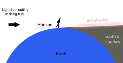

This figure from Sky & Telescope explains it well:

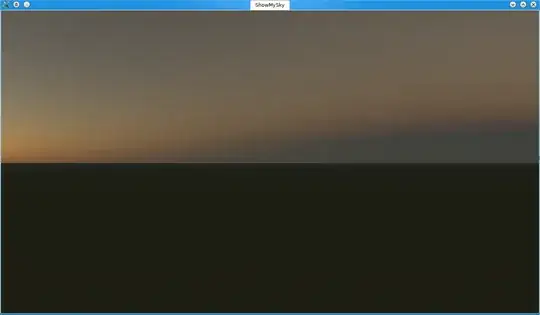

You're completely right. If you simulate light scattering only, you'll get exactly this result: a sandy-colored sky, with a bit redder belt of Venus, and a gray shadow of the Earth:

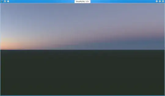

The same simulation as above, but with ozone included (and with a bit higher exposure), will look like this:
Why is the shadow more blue (less orange) than the other parts of the sky? It's because in the shadow, there's no light from the single scattering: a ray from the Sun must be scattered at least twice to get to the earthly observer. This makes the Rayleigh scattering multiplier $\propto\lambda^{-4}$ apply twice, thus increasing the blue component of the inscattered light relatively to the red component. OTOH, the other atmosphere parts being not in the shadow, means that they do have contribution from the light scattered once, which has only a first power of this multiplier.
