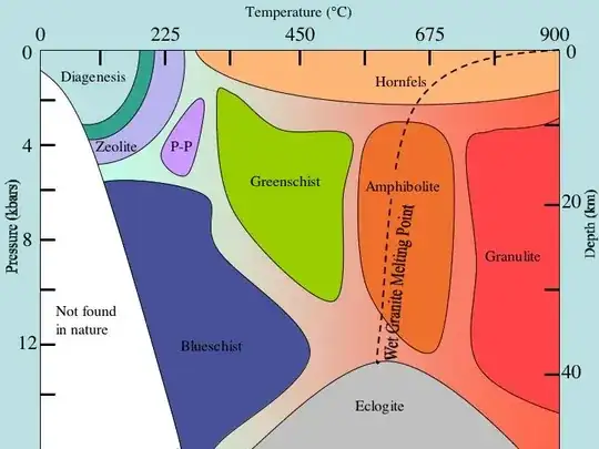

Here’s a helpful diagram of metamorphic facies, temperatures, and pressures (source: Wikimedia).
Metamorphic facies
The chart cuts off at 900°C, by which point the rock will generally be melting, putting it into the igneous rather than metamorphic category.

Referencing the pyrolysis temperatures back to the metamorphic facies, it looks as though the amphibolite facies corresponds reasonably to the range over which common plastics are completely, or near-completely, decomposed by temperature. So, when the aliens land in a few million years and start investigating the Anthropocene, they might well find some of our old rubbish in prehnite-pumpellyite (P-P) facies rocks, but there won't be much to see in the granulites. Here are some examples of metamorphic rocks from those grades.

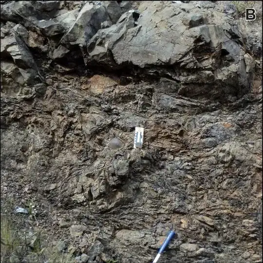

Liberty Gulch Broken Formation, a prehnite-pumpellyite facies metasandstone. Source: Raymond and Berro (2015).

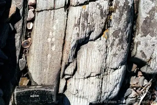

amphibolite facies
Amphibolite facies (staurolite zone) metasediments from the Scottish Dalradian. Source: Dave Waters, Dalradian Metamorphism album.
