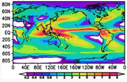

The second one is pretty reasonable: look at the global distribution of precipitation on the era of satellite data (reference).

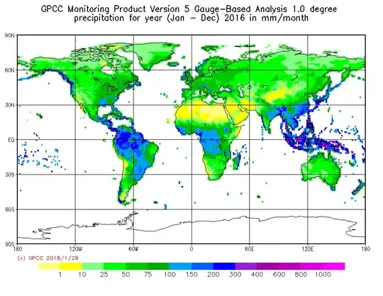

With these assumptions we only need to compute the amount of solid precipitation on land (outside Antarctica) and subtract it from the global total. And we can do so using the data provided by the Global Precipitation Climatology Centre, which provide both the global mean precipitation on land:
And the fraction of liquid precipitation on land:
I've downloaded both datasets in ASCII format, and computed that the mean percentage of liquid precipitation is 74.1%, but we can't use that value, because it might be strongly affected by areas with little precipitation. So if we compute a cell by cell total SOLID precipitation per year, and multiply that for the surface of a 1°x 1° cell (considering the effects of latitude), we get a total of solid precipitation for 2016 of 1.5e13 m³.
So with the additional assumption that 2016 was a representative year. That will take your total precipitation of 5.1e14 m³ per year to 5.0e14 m³ per year of RAIN only.
Perhaps we should have expected that there is not much of a difference given that most of the rainfall happen on the sea (The total precipitation on land for 2016 was 1.1e14 m³ meaning that the 13.6% was solid and 86.4% was rain).

But again, if you look at the map of global distribution of precipitation, the fraction coming from latitudes at which you could expect sea surface snow is rather small, so the correction coming from snowfall over the sea is likely to be a pretty small one too.
