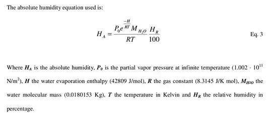

You can easily achieve that assuming that there is no sources of water vapour inside, so the absolute humidity (mass of water per volume of air), remains constant. This excerpt from my undergrad tesis will explain the formula for absolute humidityenter image description here

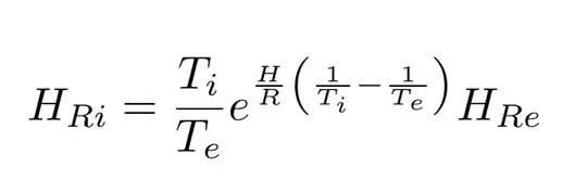

Once you know the absolute humidity, you can adapt the same formula to calculate the relative humidity of a parcel of outside air (of now known content of water), that is taken from outside to inside a building where its temperature risen to a new value. If we add subscripts "e" to exterior temperature and relative humidity and "i" for interior ones. Most of the constants can be dropped and the interior relative humidity would be given by enter image description here

  • I am looking for relative humidity inside but I think that the equation would help me. Thank you very much. – klarkson Jan 27 '18 at 06:48
  • @klarkson I've improved the answer for that case, have a look at the changes. If it solves your problem please accept the answer. – Camilo Rada Jan 27 '18 at 16:40
  • can you please tell me above equation of relative indoor humidity is from which source – Vanshita Sharma Jun 16 '21 at 22:22
  • @VanshitaSharma I'm sorry but in my undergrad dissertation I did not include the reference. But it is a standard formula you will find in many sources. If you find a reliable source I can add as refernce for this please share it here, so I can add it to the answer. – Camilo Rada Jun 17 '21 at 22:51
