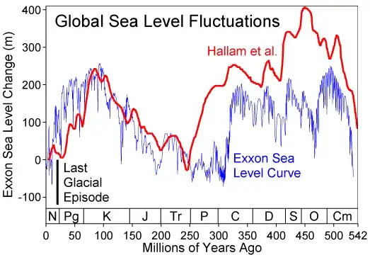

From what reference point/level are prehistorical (e.g., Precambrian era) sea levels estimated? As I understand things, the following are true:
  1. Since the formation of continents, land elevations everywhere have been continually changing due to plate tectonics, weathering, sedimentation, etc.
  2. The total volume of ocean water has been essentially the same since formation in the early Hadean.
  3. Water seeks its own level.
So is the rise and fall of sea level derived from the geological record measured relative to the adjacent land, or the center of the earth, or what?

    Are you asking specifically about the pre-cambrian or just about historical paleoclimate sea levels in general? If it is the latter you might want to look at this question. https://earthscience.stackexchange.com/questions/264/sea-level-in-paleogeographic-maps?rq=1 – John Oct 29 '17 at 13:17
Short answer: Nobody knows. Estimates of post-cambrian water levels are done by studying geology and where shorelines were in the past and what land was under water and working out from that how high the sea level probably was. There are no pre-cambrian sea level estimates that I know of.
Working out how much water was on the surface of the Earth, especially during the pre-Cambrian era is a difficult subject with much uncertainty. While the total amount of water on Earth may not have changed too much too much over the last 3 billion years, ground water vs surface water, and the shape of the ocean basin and the role of volcanoes and tectonics add to the uncertainty. There's still some uncertainty on snowball Earth and if it went all the way down to the equator over the oceans. Sea level over the pre-cambrian requires working out the specifics of snowball earth. It's a tricky subject full of uncertainty.
Long answer that also says we basically don't know:
I've never seen a pre-cambrian era estimate on sea level so I don't know how they are estimated. This is the oldest I could find.
As the article explains, historic sea level is estimated by finding where the shorelines were at geologically historic time periods and looking at what was under water. There's probably a pretty significant margin of error in those estimates I would think.
The article also says
The main factors affecting sea level are the amount and volume of available water and the shape and volume of the ocean basins. The primary influences on water volume are the temperature of the seawater, which affects density, and the amounts of water retained in other reservoirs like rivers, aquifers, lakes, glaciers, polar ice caps and sea ice. Over geological timescales, changes in the shape of the oceanic basins and in land/sea distribution affect sea level. In addition to eustatic changes, local changes in sea level are caused by tectonic uplift and subsidence.
Over geologic time sea level has fluctuated by hundreds of meters. Today's interglacial level is near historic highs and is 130 meters above the low level reached during the Last Glacial Maximum 19,000–20,000 years ago.
So, key factors are obviously ice ages and glaciers, as well as the shape of the ocean basin. The movement of continents affects the shape and depth of the ocean basin, so continental movement likely has an effect.
As a somewhat small but fun example, the Mediterranean Sea has about 3.75 million cubic km of water in it and the sea is thought to have been a dry valley some 5.33 million years ago that, once the straight of Gibraltar gave way, was quickly filled by the Atlantic ocean. That's just a theory. It may have filled much more slowly, and over 5 million years ago, it might have been a significantly different size too, but if we use the 3.75 million cubic km number over today's 361.9 million square km of ocean surface, that works out to a 10 meter drop in sea level to fill up the Mediterranean valley. 10 meters isn't a big change in the grand scheme of things, but if it happened over as little as a year, as one hypotheses suggests, that would have been quite something to observe a 10 meter drop in sea level over a single year or so. However long the Mediterranean took to fill, it's a nice example of how shifting land can affect sea level.
Historic estimates are made (as noted above) by studying where the shorelines were and studying what was under water and trying to piece together an estimate from that. Formation of glaciers like the Antarctic Glacier, which would raise sea level 58 meters if it melted, affect sea level too. The antarctic glacier began to grow in earnest about 34 million years ago. Greenland is another 6 meters and that formed much later, over the last million years or so.
Geological history of ice ages is fairly well understood, though the total amount of water in those glaciers might have some uncertainty. The shape of the ocean basin is (I think) less well understood over the last 600 million years or so.
The ice age periods, 260 to 360 and 420 to 450 million years ago should correspond to drops in the chart, below. The recent ice age period is just 2.5 million years long, and too short to be well represented but the 34 million years when the antarctic ice formed is apparent.
Speaking strictly for the geological record, it's not directly measured, but estimated by the methods discussed above, looking at geological records of old shorelines and land that was once under water and working out an estimate.
Sea level from the center of the Earth is mostly done for modern measurements. You can measure sea level against the land, but land can rise and fall, or it can be measured from the center of the Earth, independent of land shifting. I don't think that's particularly relevant to your question on geological estimates of sea level.

  • I appreciate your thoroughness and the corrections...so let me propose an example: The text I'm reading discusses the Cretaceous Interior Seaway, roughly covering the US Great Plains about 250 mya. The chart above (and in my text) shows the sea level at that time at about + 250 meters / 750 feet, and the map shows its western shore lapping up about in the middle of Colorado. Say the current elevation there is 5,000 ft. above current sea level. I'm guessing then that a combination of continental uplift and the water "going somewhere else downward" has caused the difference of 4,250 ft.? – charlie_sar Oct 30 '17 at 00:25
  • wait, sorry...in order to peg the estimate for the sea level rise at 750 ft., the assumption would have to be made that all of the 4,250 ft. is due to uplift. – charlie_sar Oct 30 '17 at 00:33
  • @kathyslover That's how I would read it. It's entirely possible that Colorado has lifted 4,250 feet over 250 million years. I also wonder how accurate all these estimates are, they seem like they'd be very hard to average out globally. The Wikipedia chart above shows two estimates and those two estimates vary quite a bit. 250 million years ago was the great dying and the enormous volcano/mantle plume over Siberia. That may have played a role in the rise in sea level. That volcanism may may have been triggered by a large meteor or comet. Many moving parts to this question. – userLTK Oct 30 '17 at 01:44

First there are many ways of estimating sea level, you will have to examine a specific paper to see what they use. As a rule of thumb global sea level is usually measured relative to current sea level in paleoclimate studies this is confusingly an absolute measure, usually eustatic (volume of the ocean water). Keep in mind sea level is different across the planet's surface when measured from the center of the planet thanks to spin and gravity anomalies so there is no absolute measure of height, so instead volume is used. There are of course many relative measures of sea level but this is more referring to sea depth than anything else and thus are local effects.
Second if you haven't guessed, the volume of the ocean is not constant it changes quite a bit, both the volume of the water and the volume being occupied, the volume of the container if you will. The mass is more constant (on the scale being measured) but even then influenced by removing or adding water. Many measures of sea level are eustatic, meaning they are measuring change in the volume of the ocean.
On the global level there are two big issues influencing sea level, temperature and available water(mostly ice caps).
The temprature has a big effect due to thermal expansion, change the temprature and the volume of water changes even if the mass is the same. Most of the our current sea level rise is due to thermal expansion not melting glaciers.
The second is if there are ice caps and how big they are, since ice frozen on land is not in the ocean. The earth right now basically has only one ice cap (antarctica). Icecaps are largely controlled by whether their are continents near the poles. Isolated dry basins that flood can have a similar effect by increasing the area that needs to be filled, for instance when the mediterranean flooded it is estimated to have dropped global sea level (of the rest of the ocean) by ~ 9 meters in a about a year or two, which may be one of the most dramatic change in history, and probably scared the crap out of the humans around at the time. The drop is caused by increasing the volume being filled without changing the volume of water.
There are lots of smaller and/or local effects that can change sea level or local sea level and wiki has a decent chart of them here, these include age of the oceanic plates, plate rebound, and intercontinental reservoirs.
