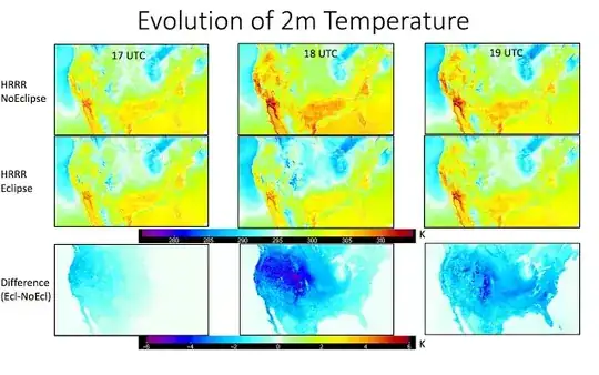

The moon does not normally affect weather much, but during a solar eclipse, there is reduced solar radiation reaching the surface of the Earth. This causes cooler temperatures and changes in wind speed/direction than would not otherwise be predicted. The NOAA ESRL HRRR took the solar eclipse of August 21, 2017 into account when doing the weather forecast and found cooling of up to 6 degrees Celsius in some places. Do any other weather forecast models take solar eclipses into account? Or, is this the first time? Why don't weather forecast models normally take solar eclipses into account?

Perhaps part of it has to do with the fact the weather changes due to eclipses are usually fairly friendly/tame. This GOES 16 satellite loop from the southeast US during the eclipse shows a large percentage of the cumulus buildup dissipating as solar input dropped. And this great meteogram from the Oklahoma Mesonet (this site is Blackwell, Oklahoma in northern Oklahoma, though most sites show some impact) shows the slump in solar radiation very well (the bottom plot) and also temperature and wind speed changes during the early afternoon of August 21, 2017 (very slightly left of the middle of the time period of the graph):
Typically changes like cooling and slackening winds are not conducive to storms, and as the graph shows, are rebound soon after the eclipse end.
