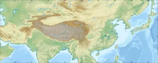

Look at how similar the elevation map is of the region:
enter image description here From Wikipedia
And that goes really well with Why Is It Colder in the Mountains Than at Sea Level

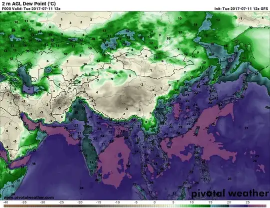

As to why this area stands out in comparison with other locations at the same latitude, the moisture in the air has quite a bit to do with it:
dewpoint 071117
Today's dew points, courtesy of Pivotal Weather
Indeed, you can see it is fairly dry over parts of central and western China compared to many other places, such as eastern China and back nearer Europe... due in part to the affects of the mountains and distance from large bodies of water... though you may also notice other spots to the west do show comparable moisture for this date despite producing lower temperatures.

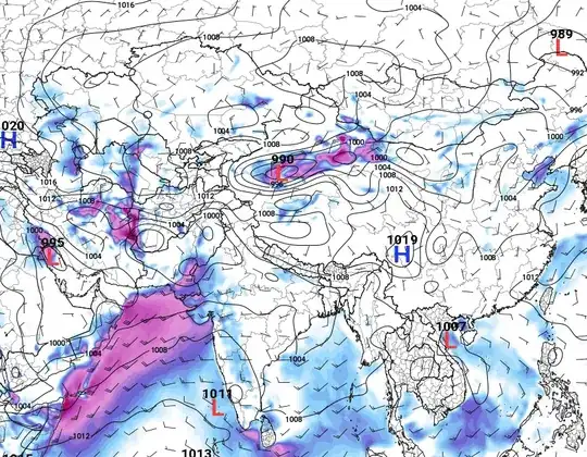

And then wind direction gives one final explanation why it's not as warm further to the west:
winds 071117
The northerly winds have been in place for a while back in Kazakhstan and Uzbekistan have brought slightly cooler temperatures down from the north, whereas the flow into China is less consistent and has only recently started shifting. Even in the summer, wind changes and even fronts are still often very important in the temperature layout.
