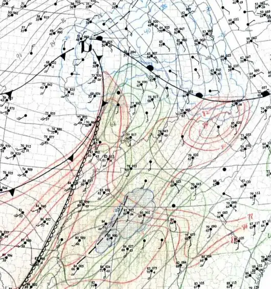

Not only are fronts associated with (extratropical) lows, but by in large, fronts are extensions of those lows, as shown by the following hand analysis (from the US Storm Prediction Center):
Analysis
There's a lot going on in the image, but try to focus on the many black lines, which show pressure: they're kinked around each front (and even the dryline). This indicates that the pressure is higher on either side of the front. (for another good example: this set of images from the 1993 Storm of the Century from the National Weather Service). Now the kinks in these drawings aren't caused by the actual layout of observation in the image, but added by the understanding of the meteorologist performing the analysis. Generally observation sites are too widely spread out to see the small pressure kinks. However, they do sometimes show up in high-resolution numerical weather models forecasts, even despite not being in the initial observation data they run from:

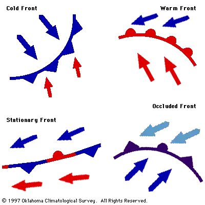

Indeed, this is exactly what forms and sustains a front. You can look at surface weather maps and almost always see this convergence, or gathering together of winds, at fronts, even if only slight, as indicated in this idealized diagram set:
![![![frontwinds
(Image modified from OKFirst, the education arm of the Oklahoma Mesonet program. See comments for modifications I made.)
The thing is, there's only a few basic forces that drive wind formation... and in the lower atmosphere, it turns out that the pressure gradient force outweighs the others enough such that, on the large-scale, air always flows from higher pressure towards lower pressure.
So if you put those two ideas together:
  • To create/strengthen/sustain a front, you need wind converging together
  • Air at low-levels flows from high pressure to low pressure...
The resulting conclusion is that the location where winds are flowing together... which is the front itself... must be a low pressure area.

  • I modified the frontal image at OKFirst because I didn't feel it properly identified typical winds along warm and stationary fronts, and didn't show typical directions of such fronts. I don't believe the alternate direction of winds north and south of the stationary and warm front are realistic at all, as they suggest different low pressures are dominating flow. Note that stationary fronts with winds from the west often regularly happen where a cold front has stalled. The light blue arrows indicate cool (rather than warm/cold) air – JeopardyTempest Jun 19 '17 at 16:45
