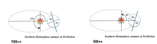

The precessional effect on climate is caused due to two factors:
(1) Axial Precession
(2) Apsidal Precession
The precession of the apses doesn't cause a change in climatic state by itself. However, this motion is in the same sense as the axial precession (gyroscopic motion of the earth's axes). This effect reduces the period of precession from 26kyr to ~21kyr.
Combined, the two effects cause what is known as the precession of the equinoxes. If you consider this a cyclic process, the two extreme precessional configurations are shown below: enter image description here
See NH++. In this configuration, NH summer is at perihelion. Thus, during NH summer, earth is closest to the sun, and therefore Northern hemisphere has a strong summer. During NH winter, earth is farthest from the sun, therefore Northern Hemisphere has a weak winter as well. Thus in this precessional configuration, the earth has extreme seasons in the Northern Hemisphere.
Now see SH++. In this configuration, SH summer is at perihelion. Thus, during SH summer, earth is closest to the sun, and therefore the southern hemisphere has a strong summer. During SH winter, earth is farthest from the sun, therefore southern Hemisphere has a weak winter as well. Thus in this precessional configuration, the earth has extreme seasons in the southern Hemisphere.
RRC
  • 189
  • This is incorrect. The current configuration has perihelion very close to summer solstice in the southern hemisphere. The Earth is very close to the "SH++" configuration in this answer. Yet southern hemisphere seasons are not extreme. Northern hemisphere summers are hotter than are southern hemisphere summers, and northern hemisphere winters are colder than are southern hemisphere winters. The timing of Earth's perihelion and aphelion has but a tertiary effect on the seasons. The uneven distribution of land vs ocean is more important than is the timing of perihelion and aphelion. – David Hammen Nov 01 '15 at 09:17
  • The answer here considers only the effect of orbital forcing on the earth, which is correct here, and has been accepted since the time of Milankovitch. The uneven distribution of land vs ocean created a different level of complexity on the climate response of the earth to a given orbital forcing, which is beyond the scope of this answer. – RRC Nov 03 '15 at 20:10
