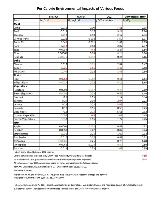

I was recently on the hunt for comprehensive values of water, CO2 and energy per kcal of various foods. I found this post useful along the way, although I ended up using some other sources that had a larger variety of foods to create my own list.
The table of my findings (sources at the bottom) is attached here. Enjoy! enter image description here
