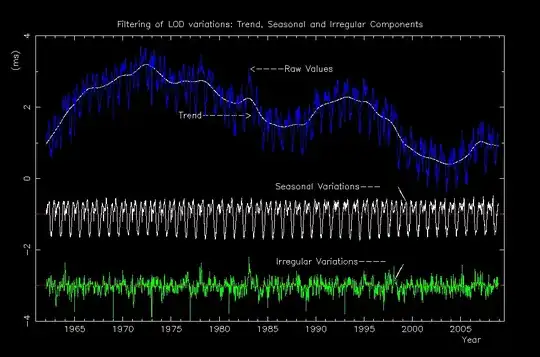

Those leap second adjustments make it a bit hard to see what's going on. Here's a much better portrayal:
Source: https://hpiers.obspm.fr/eop-pc/earthor/ut1lod/UT1.html_nov08
The first thing you should look at in the above plot is the top curve. This is LOD, length of day (better: excess length of day). The length of a day is 86400 seconds and a tiny bit more. LOD is defined to be just that tiny bit more. LOD decreased between 1973 to 1987 and then again between 1993 to 2004. The Earth's rotation rate was very slightly increasing during those intervals.
As mentioned above, angular momentum is being transferred from the Earth to the Moon, but this is a very slow process. What this means is that the Earth's total angular momentum is very nearly constant over the span of years, even decades. Note that it's angular momentum, not angular velocity that is the nearly conserved quantity. Angular velocity can change while angular momentum remains constant. The graph above depicts change in period, and hence change in angular velocity.
The Earth comprises five different rotating systems: The inner core, the outer core, the mantle and crust, the oceans, and the atmosphere. Our terrestrial timescales, UT1 and UTC, are based on the rotation of the mantle and crust only. These five systems do not quite rotate in unison. For example, the inner core is currently rotating slightly faster than one revolution per day while the outer core is rotating slightly slower than one revolution per day. These systems transfer angular momentum amongst themselves.
Some of this transfer is visible in the "Seasonal Variations" plot in the above graph. The mantle and crust transfer angular momentum to and from the oceans and atmosphere on a seasonal basis. What's left after removing those season variations and other high frequency variations (shown as "Irregular Variations" in the above graph) is the white "Trend" line overlaid on top of the blue plot. This white curve shows multi-year variations in the length of day.
