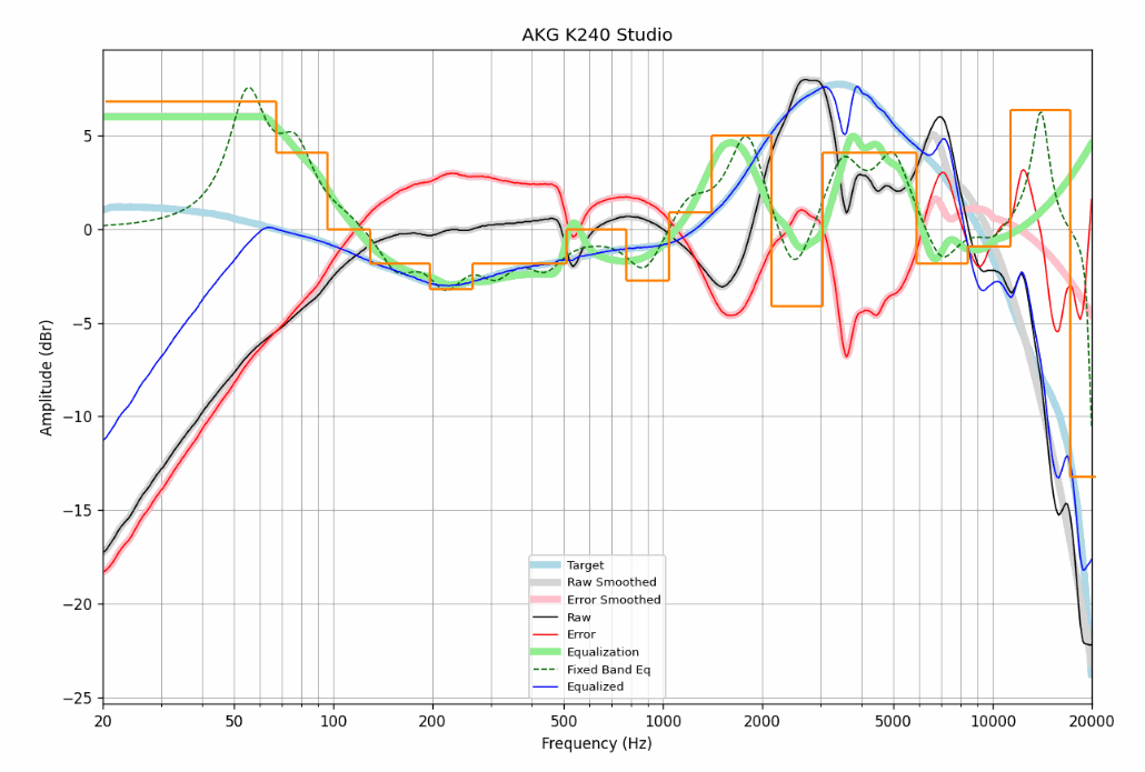

  • I made little change in code to export foobar2k preset. Band gains was calculated using normal peaking filter with Q=2.871 and I also calculated compensation curve between filter types (peaking vs bar). Here's plot (orange is foobar2k preset response): AKGK240Studio-FBKpreset response.png (7 4 0 -2 -3 -2 -2 -0 -3 1 5 -4 4 4 -2 -1 7 -13 – Juha P Jul 11 '23 at 21:08

  • That way you get gain values for 18 filters but, not the combined response data which actually is the important data which should follow the target response (see that response plot behind my link (separate filter responses drawn with green solid lines vs their combined response drawn with dashed red). Filters used in SuperEQ do not have as much effect on neighboring bands (each AutoEq's IIR filter effects in full frequency range when each SuperEQ filter effects in its bands bandwidth range (as seen in same plot)). – Juha P Aug 04 '23 at 21:07
