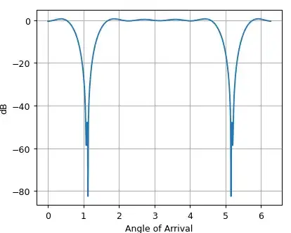

Demonstrating this is a 13 element antenna array using firls to concentrate rejection in the broadside angle direction of $0.35\pi$ to $0.40\pi$ as follows:
coeff = sig.firls(13, [0, .2, .35, .4, .5, 1], [1, 1, 0, 0, 1, 1])
The resulting pattern when plotted as we would typically view a filter frequency response (which this is!) is given below:
Antenna pattern
And when plotted as a typical antenna pattern on a polar plot of magnitude in dB versus angle of arrival it would appear as shown below:
antenna pattern polar
Note that in the plot above 0 to 180 degrees corresponds to the front direction of the antenna and 180 to 360 is the backlobe for a linear antenna array. It is typical to have the front centered on 0 degrees instead of 90 degrees as done above, in which case the above pattern should be rotated clockwise 90 degrees- I left as is to be consistent with the frequency axis returned from the frequency response tools).
When reviewing the roots (zeros) for this derived solution, we see how two of the zeros have been concentrated together on the unit circle in the direction of the null. The solution for the other zeros is such that we get a minimum least squares error from unity gain for all other directions with maximum rejection at the null within the constraint of a linear-phase spatial solution (given what firls provides, not that a linear-phase solution is necessary for this).
