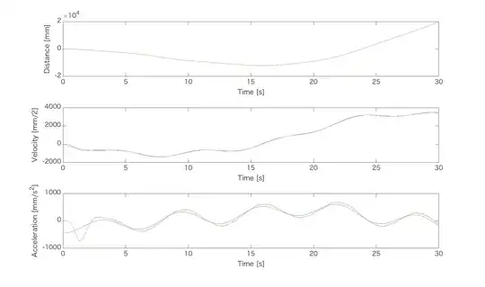

I simulated the phase lag induced by the Kalman filter for illustration. I generated signals for simluation as follows:
Hz = 1000; % signal's frequency
time = 0:1/Hz:30; % time interval for simulation
accel = 200-400*cos(time*2*pi/40) - 500*sin(time/40) + 80*sin(time/10) .* cos(time/2-10) - 240*cos(time); % true acceleration
vel = cumtrapz(accel)/Hz; % velocity
dist = cumtrapz(vel)/Hz + 10*randn(1,numel(time)); % true distance with gaussian disturbance
Parameters used in the filter: $q = 20,~ er=1,~ r=10$. Blue lines show true distance/velocity/acceleration and red lines show filtered distance/velocity/acceleration. In acceleration estimation, we can observe large phase lag.
Any help would be warmly welcomed and appreciated.

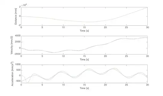

In response to a nice answer by @Luezoid, I also tried a constant jerk model instead of constant acceleration model [2]. The state transition matrix $F$ and covariance matrix of the process noise $Q$ is changed as follows: \begin{align} F&= \left[ \begin{array}{cccc} 1 && dt && dt^2/2 && dt^3/6 \\ 0 && 1 && dt && dt^2/2 \\ 0 && 0 && 1 && dt \\ 0 && 0 && 0 && 1 \\ \end{array} \right] ,\\ Q&=\left[ \begin{array}{cccc} dt^7/252 && dt^6/72 && dt^5/30 && dt^4/24 \\ dt^6/72 && dt^5/20 && dt^4/8 && dt^3/6 \\ dt^5/30 && dt^4/8 && dt^3/3 && dt^2/2 \\ dt^4/24 && dt^3/6 && dt^2/2 && dt \\ \end{array} \right], \end{align} where we assume time interval is sufficiently small. The other things remain the same as the constant acceleration model.
Here is the code.

I ran the simulation with the same data and obtained the results with different filter parameters.
Result 1 Constant jerk model with parameters: $q = 20,~ er=1,~ r=10$. enter image description here Result 2 Constant jerk model with parameters: $q = 50,~ er=1,~ r=10$. enter image description here
As observed in the results, I got larger amount of estimation error in acceleration compared to the constant acceleration model. Can we somehow reduce phase lag while keeping error level low?

  • Hi! You have about one second lag in acceleration estimation. Is it this lag you complain about ? Yet your position estimation seems quite accurate ? (may be still not enough for your application accuracy ?) – Fat32 Mar 09 '20 at 22:36
  • @Fat32 Thanks for your comment. Yes the lag in acceleration is too large to build a control system that takes acceleration into account. – mhirano Mar 10 '20 at 01:16

  • Thanks for your answer! I tried the constant jerk model (4-state Kalman filter) and obtained less phase-lag acceleration estimation, but also introduced much larger error. I edit the question to share the trial. Can we somehow reduce phase lag while maintaining error level? – mhirano Mar 23 '20 at 08:25
  • Just some thoughts... The simulated acceleration is periodic, so really you would need an infinite order polynomial to truly capture the process dynamics. The process noise captures this model mismatch, so increasing Q essentially gives the model more flexibility, but will increase the estimate noise. Decreasing Q increases lag. An excellent discussion on this topic which directly addresses tradeoffs in model order, selection of Q, and the resulting filter lag and performance can be found in Ch. 5 of Fundamentals of Kalman Filtering by Paul Zarchan. Highly recommend. – Luezoid Mar 23 '20 at 15:34
