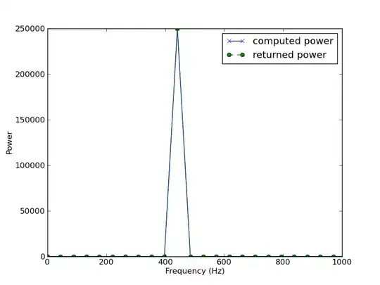

Just had a look, and from the wikipedia definition of the Goertzel algorithm, the frequency in the cosine weight should be a normalized frequency (as for the DFT, by the way). If you modify your code as below, you should get the right output (note also that your computation of the power led to negative powers -sic-, removing a redundant factor 2 solved that issue as well).
The modified code:

    # JLD: with 1000 samples, a sine at 441Hz leads to a DFT with only one
    # non-nul component:
    sine_wave = np.sin(2*np.pi*441*t)[:1000]

I did not thoroughly test that code, and I can't guarantee it to be bug-free, but for your simple example, it seems to work well. I obtain the following figure:
output of above python code
Hope that helps!
Regards!
Jean-Louis!
