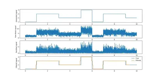

I think the most straightforward basic approach to detecting noise/variance levels is:
highpass -> rectify (or square) -> lowpass
There are many types of 'highpass' or 'lowpass' like operations/filters that you can choose from and tune based on your application. Below I use diff (e.g. derivative) effectively as a highpass filter, and a couple rolling quantile filters for the lowpass part. Then I use round to discretize the levels.

Note 1: A rolling mean with a small window, followed by a rolling max with a larger window gives similar behavior to the first rolling quantile. The second quantile is just a median filter. Using efficient mean/median/max filters (e.g. bottleneck.move_median) might be much faster.
Note 2: Depending on how your noise is distributed (in magnitude and frequency) you need to tune the quantile thresholds and window sizes.
Note 3: Since this relies on good statistics, results are going to get worse with fewer points to sample. For example, the following is with PN=100 enter image description here
argentum2f
