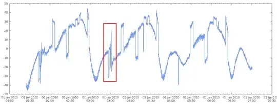

I have a time series with lots of steps/jumps (data file here). A plot is given below. I would like to subtract an appropriate value for each of these square wave features to bring them back down to the baseline of the signal. A median filter works really well for removing a small number of outliers in a row, but in this case I probably need a different approach since the square wave jumps can have different durations as seen. A common method I've seen for doing this is to compute first differences of adjacent samples, and look for large differences to detect jumps. I implemented this method but the problem is it often fails, since the one tunable parameter for the method is a threshold value $t$ which the first differences must cross in order to detect a jump: $$ | x_{i+1} - x_i | > t $$ As can be seen in the plot below, the jumps I have are often different sizes, so a constant threshold value isn't the best approach. In particular, in some cases there is an interesting signal where adjacent samples can change by large values without being a jump! I have highlighted such a region in red.
Time series
Below is a zoomed in view of the red box area. You can see there is a square wave jump followed by an interesting signal. The red arrows depict a place where adjacent samples from an interesting signal have a larger distance between them than some of the jumps in the signal. Therefore a constant threshold method with finite differencing will not work for me.
Does anyone know of a robust procedure to detect and subtract the square wave jumps to end up with a smoothly varying signal with no jumps? I'm sure this must be a solved problem but I haven't had much luck searching online.
