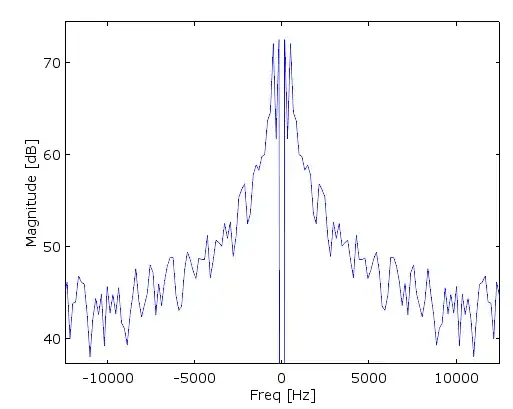

Here is the FFT of that portion of your sequence. I had removed the mean before taking the FFT which is why there appears to be a large null in the center.
The peak is near 500 Hz, with around 170 Hz of resolution.
This is what the FFT looks like without removing DC or the initial transient in the beginning. enter image description here
Windowing your data first can help reduce the side-lobes in frequency to give you more dynamic range (if you are looking for lower level signals that may be masked by the side-lobes from larger signals), but know that that will decrease your frequency resolution further.
Here is the same plot as above of your entire second data set after applying a Kaiser window.
And a zoom in of above showing the FFT bin sample locations:
Zooming in further, we see the detail below. The Kaiser window used was with a Beta of 8, which has a frequency resolution that is approximately 3x wider than the non-windowed example. Since I used the complete data set (and the effects of the impulse are masking the lowest frequency region accordingly), the resolution non windowed would be 112.6 Hz, and with the window used around 330 Hz.
