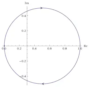

Now if I take Nyquist Plot of $\frac{1}{s+1}$:
Again, the origin is not outside the curve, but now the system is stable.

In my understanding, the origin of the Nyquist Plot of $\frac{1}{s+1}$ should be outside the curve, since it has no poles and zeros in the right half plane. Also, the origin of the Nyquist Plot of $\frac{1}{s-1}$ should be surrounded by a counter-clockwise loop, since it has 1 pole and 0 zeros in the right half plane.
Shouldn't the Nyquist Plot of a given transfer function tell the difference between poles and zeros just by looking at how many times (and which direction) the origin is surrounded by plot loops?

The problem here is that for the given functions, the usual Nyquist contour (see figure below) results in Nyquist plots from which no decision can be made about stability.
Nyquist contour ($M\to\infty$) (from Signals and Systems by A.V.Oppenheim)
The reason is the fact that for all three functions the limit for $|s|\to\infty$ equals zero. So the function value along the semi-circle in the right half-plane (with infinite radius) is zero. This is not always a problem, but for the given functions (with no finite zeros) it results in Nyquist plots from which the encirclements of the origin cannot be determined.
This problem can be solved by modifying the Nyquist contour along which the complex variable $s$ moves. For the function $F(s)=\frac{1}{s}$, the contour shown above needs to be modified anyway because poles on the contour are not allowed. The usual modification is the introduction of a semi-circle in the right half-plane with infinitesimal radius centered at the origin (see this answer for a figure of such a modified contour.) In that way the pole at $s=0$ is avoided but the contour still encloses the complete right-half plane. Note that this modification is not necessary for the other two functions, which do not have poles on the contour.
The other modification that will make visible the encirclements of the origin is to leave the radius $M$ in above figure finite. Of course, this implies that our contour does not enclose the complete right half-plane. However, the radius $M$ can be made as large as necessary. Moreover, for the given functions we know the pole locations anyway and we only want to show that the Nyquist plot along the modified contour does give the expected result.
The modified Nyquist plots are shown in the figure below. The finite radius $M$ results in Nyquist plots with a small circular segment close to the origin. The radius of that circular segment is (approximately) inversely proportional to the radius $M$ of the Nyquist contour.
For the function $F(s)=\frac{1}{s}$ (left-most figure) we see that the Nyquist plot does not encircle the origin, which agrees with the fact that there are no poles and no (finite) zeros in the right half-plane. [Note that the pole at $s=0$ is outside the Nyquist contour due to the infinitesimal semi-circle in the Nyquist contour mentioned above.]
There is also no encirclement of the origin for the function $F(s)=\frac{1}{s+1}$ (center figure). This is in agreement with the fact that there are no poles and no (finite) zeros in the right half-plane.
Finally, for $F(s)=\frac{1}{s-1}$ (right-most plot) we have one counter-clockwise encirclement of the origin, corresponding to one pole and no (finite) zeros in the right-half plane.
