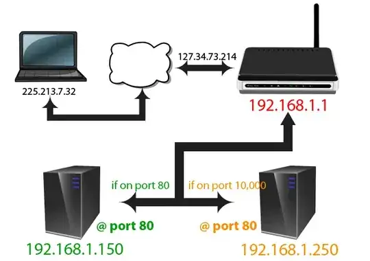

If you want it to be accessible by the internet, you would need do port forwarding on your router to route access from your public ip:port to your internal ip:port.
