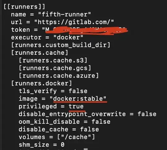

I want to share the solution!
just add image = docker:stable and privileged = true
and that's all! enjoy!
