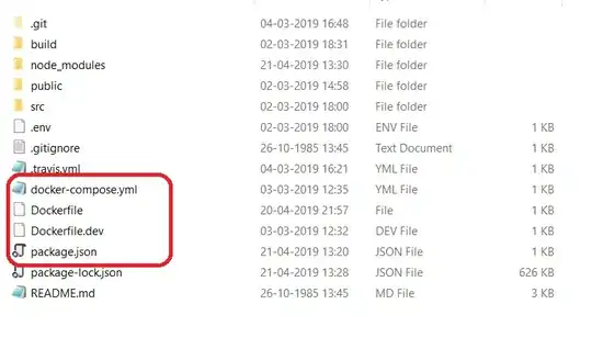

I am a very beginner in the Docker world, while I am trying to experiment with Docker file and Docker-Compose I am facing the below error, I now am able to understand it is related to declaring volumes in Docker compose, if I remove volumes, everything works fine, may be it is trying to refer back to the package.json file in my local drive and somehow container is not finding the package.json inside the container, yet to figure out how to solve this.
enoent ENOENT: no such file or directory, open '/app/package.json'

My directory structure as as shown below,
Executed the below statement and the corresponding response,
$ docker run -it --rm -v "$(pwd):/app" busybox ls -l /app
the input device is not a TTY.  If you are using mintty, try prefixing the command with 'winpty'
Update: I now am able to understand it is related to declaring volumes in Docker compose, if I remove volumes, everything works fine, may be it is trying to refer back to the package.json file in my local drive and somehow container is not finding the package.json inside the container, yet to figure out how to solve this.

    Do you have a package.json file in the current directory? Is the drive where your files are saved currently shared to docker (part of the docker preferences) and have you attempted to reset the credentials? Try running docker run -it --rm -v "$(pwd):/app" busybox ls -l /app and show the output (replacing $(pwd) with your current directory if you aren't in a bash shell). – BMitch Apr 24 '19 at 13:03

  • Have you shared the correct windows drive (most likely C:/ or D:/) to your docker containers? https://rominirani.com/docker-on-windows-mounting-host-directories-d96f3f056a2c – Preston Martin Apr 25 '19 at 16:44
  • Yes PrestonM, mine is windows machine, so I tried in git bash where $(pwd) works. I wrote an entirely new node application, I am getting the same error when trying to do Docker build. Looks like something wrong with my machine in particular. – Jophin Michael Apr 25 '19 at 17:27
As mentioned in the post/question, it was an issue with volumes, my PC's firewall was blocking the Docker from accessing the drives in my local machine, I reset the credentials in 'Docker for Desktop' app in the shared drives section and everything was back working once again :). Thank you everyone, in fact BMitch was suggesting the same solution, but I was a completely beginner and I did not comprehend it well. Thanks everyone for your responses.
