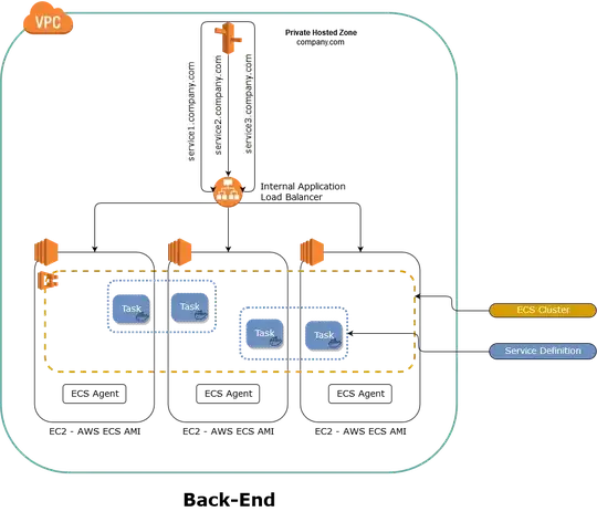

Currently, we have on our test environment an ECS Cluster with micro services deployed. All micro services are talking to each other through Route53 DNS CNAMEs like service1.company.com, service2.company.com, etc.
Here is a simplified schema of the infra: ECS Cluster for micro services
The ALB listens on port 80 and everything works fine.
Now comes the troubles: I'm trying to build a blue/green deployment infra.
I basically know how to do it (HAProxies, 2x ALBs, 2x ECS Clusters). What I want to acheive can be seen https://www.youtube.com/watch?v=KJOORneBTHI
I'm stuck with the fact that we are using CNAMEs for our micro services communications.
  • So on the blue part:
CNAME service1.company.com -> ALBBlue
  • On the green part:
CNAME service1.company.com -> ALBGreen
But that's something I cannot do of course.
How can I do?

You should have 3 names when you're willing to do a blue/green deployment.
Two set of names, one for blue, one for green, which will works as is, and a production entrypoint which will point to either the blue name or green name.
The point of a blue/green deployment is to be able to test the full deploy before switching the clients entry point, so your services calls themselves don't have to use the entry point name itself.

  • But how to make the micro services point to each other in the same Cluster? I cannot tell the micro services that they are on the blue/green by modifying their URL (service1.blue.company.com/service1.green.company.com) – Kaymaz Sep 17 '18 at 08:50
  • Why can't you use blue/green names on each cluster ? – Tensibai Sep 17 '18 at 08:51
  • So it means the micro services must know in which "env" they are. That doesn't seem right to me. I must be missing something – Kaymaz Sep 17 '18 at 08:52
  • That's just a variable you give to your services, as well as any credential, db location, whatever which is cluster dependent. – Tensibai Sep 17 '18 at 08:53
  • Ok so I would have blue.company.com, green.company.com and a third one? – Kaymaz Sep 17 '18 at 08:55
  • Yes, your services should be able to take at least a dns suffix from an environment variable to build their own and others services urls. – Tensibai Sep 17 '18 at 08:56
