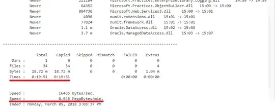

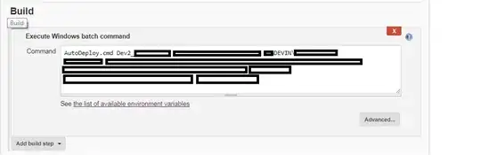

If I run the script directly from where it's located on the Jenkins Server, the script finishes in a matter of seconds. However, when I queue the script to run from a Jenkins job, the ROBOCOPY command takes roughly a minute to copy each file.
Excecute Script To Run on Jenkins
ROBOCOPY runs slowly when started from Jenkins Job

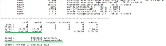

If I just run the same script directly on the (exact same) Jenkins server, the process runs a lot faster.
Robocopy runs quickly when started directly
