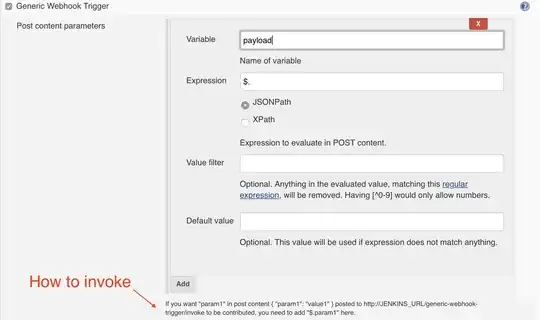

If you want to keep it simple, try the generic webhook trigger plugin.
https://plugins.jenkins.io/generic-webhook-trigger
You can trigger a build by sending an http POST using a JSON body or URL parameters.
Parse the JSON request
def req = readJSON text: payload
Now you can use it in your pipeline assuming you had a deploy function.
deploy(req.environment, req.branch)
