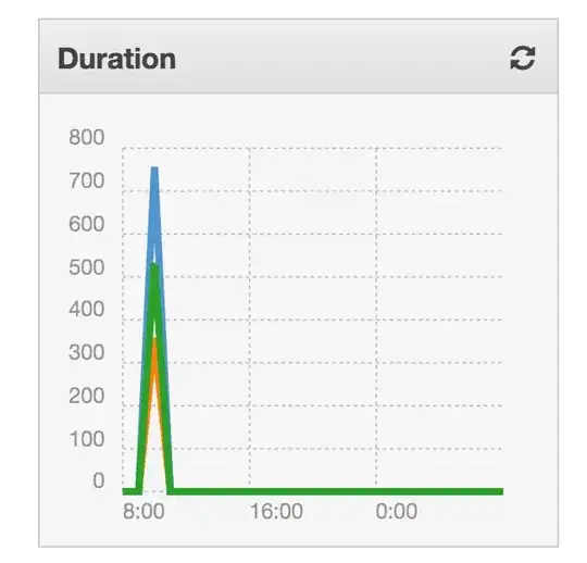

  1. Speed-Performance: The duration of a single run of a lambda function will be present in the dashboard of the Lambda's monitoring tab, which looks something like this:
So do throttles/errors/number of invocations.

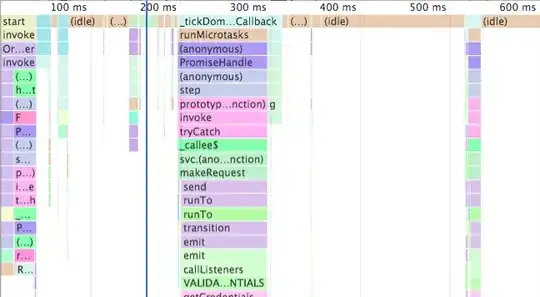

Check out the IOpipe profiler to get full v8 profiler dumps from Lambda invocations. You can load those into Chrome Devtools to see exactly where CPU time is spent, and how memory is being used for your functions.
Disclaimer: I work for IOpipe

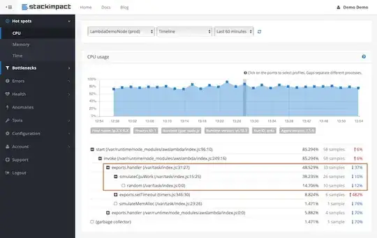

Use StackImpact agent to get CPU and memory profiles. More details in the blog post: AWS Lambda CPU and Memory Profiling (Node.js). Because Lambda Node.js process is freezing between requests, most of the other tools will probably not work out of the box.
Disclaimer: I work for StackImpact
