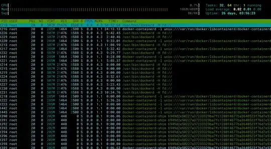

See here nothing is running or doing work: enter image description here
