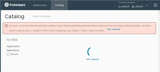

I followed the setup instructions for k3s, and kubectl in this answer. I'm getting this error when I boot into KubeApps
An error occurred while fetching the catalog: Invalid GetAvailablePackageSummaries response from the plugin helm.packages: rpc error: code = Internal desc = Unable to fetch chart categories: pq: relation "charts" does not exist.
How can I resolve this error?
Picture of the Error
When I pull the logs, I see,
