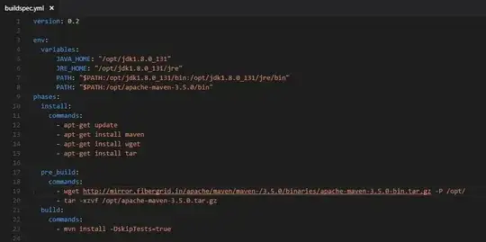

This is my buildspec file.
I am not able to figure it out... why does it fail for both yum and apt-get?

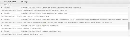

These are the logs of the build

    Both of your screenshot shows only apt-get in error... which makes sense if it's running on a RH based distribution. It's unclear what makes you think somethign with yum fail. For the future, please avoid screenshots of file content, it's harder to read and impossible to test and validate (no copy/paste possible) – Tensibai Jun 12 '17 at 11:53

Few ideas to help you
  1. When you define a "CodeBuild" project, you can specify which base image it will use to execute your commands. The one you are using is not Ubuntu yet you are trying apt-get. Try a different base image.
  2. Provide us with a better log stream.
