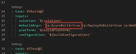

I had the same problem and fixed it with this solution:
  • for the pipeline yaml I added an additional param, could be any random name, I choose "AzureBuild" and set it to true:
  • for the *.csproj file I added a Condition to Exec with that defined param in mind:
Now this post build events are only fired for local builds and not on Azure DevOps builds.
