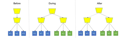

Canary Release
A new version of a microservice is started along with the old versions. That new version can then take a portion of the requests and the team can test how this new version interacts with the overall system.
1. The canary release is a technique to reduce the risk of introducing a new software version in production by slowly rolling out the change to a small subset of users before rolling it out to the entire infrastructure.
2. It is about to get an idea of how new version will perform (integrate with other apps, CPU, memory, disk usage, etc).
See also illustration (source):
Blue/Green: enter image description here
Canary: enter image description here
