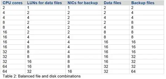

Below is from the Whitepaper - A Technical Case Study: Fast and Reliable Backup and Restore of Multi-Terabytes Database over the Network :
As a side note, its more important to test your restore strategy as a backup is ONLY GOOD if it can be restored without any issues. Enabling Instant File Initialization will considerably cut down the restore time.
Be careful when you are striping your backups as there are chances that a stripe might get corrupted or might become missing (deleted) due to machine or human error :-)
