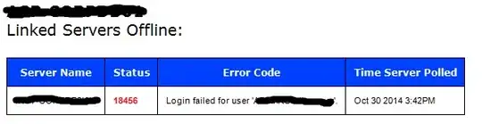

I've built a script/Agent job that goes and polls our linked servers every 10 minutes to make sure they are online. Now, when one goes offline, It generates an email and notifies me. See below: enter image description here
Now, right now it just uses a pass/fail. What I want to do is, when communication between servers goes offline, to generate not only that it's offline, but also the reason why. Similar to the read out you get from SSMS when you test a linked server and it's offline:
Is this possible? I've searched for any additional verbose parameters that may help me accomplish this but haven't been able to find any. The information gets generated in SSMS so that leads me to believe that there is some way to get it, I'm just not sure how.
Thanks as usual guys!
UPDATED Had to add some system specific functionality to this as well as my own SQL that I had already built but error reporting is online. Works with our SQL servers and our iSeries/400 environments. Here's what it spits out now:
Thanks again for all the help on this one. Might have to post this out to SSC so others can use it.
