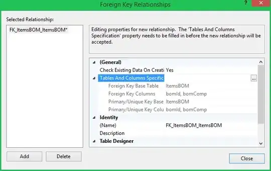

I just found such a foreign key in my own db and it must have been myself creating it. I think this just happened by accident. If I click on "New Foreign Key" in the context menu of a table with primary key (within Management Studio, SQL 2014 Express) this already automatically creates such a foreign key referring to itself. See below:
If I then don't realize that I should alter that one instead of adding a new one, it will stay there. Or, if I simply click on the [Close] button meaning this would be like a [Cancel], the foreign key would still be created after saving the table definition.
So, to me such a Foreign Key makes no sense and can be removed.
  • It's possible that you wanted to create a FK and in the process you realize the other table hasn't set its PK yet so you cancel, go to the other table and then for some reason you forget to continue with the FK process. There you have your recursive FK. – Andrew Jul 12 '17 at 14:47

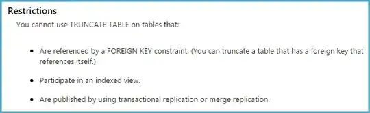

Perhaps the designer wanted to disable the use of TRUNCATE TABLE?
TRUNCATE TABLE cannot be used on a table with a foreign key constraint to another table though it can be used if there are self-referential foreign keys. From the documentation for TRUNCATE TABLE (Transact-SQL):
BOL Extract
A DELETE statement without a WHERE clause has a similar effect to a TRUNCATE TABLE (removing all rows in the table) but the DELETE statement fires delete triggers, which might be a reason to allow DELETE but not TRUNCATE TABLE.
I would do this using permissions (DELETE requires delete permission, TRUNCATE TABLE requires alter table permission), but maybe there is some reason the designer couldn't do this?
Note: Even though what the designer has done does not actually disable the use of TRUNCATE TABLE, I'm still speculating that this was their intent.
