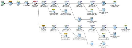

If I compare query plans between your second query and the variation with a table variable, I can see there's a definite difference between the two. The red X is No Join Predicate so that seems really odd to my caveman developer brain
If I eliminate the random bit of the query to a constant 1 % (4), my plan looks better but the Compute Scalar was eliminated so that led me to look closer
It's computing the expression for the random number after the join. Whether that's expected, I still leave to the internal wizards on the site but at least that's why you're getting variable results in your join.
2014
For those playing along at home, the above query plans were generated from a 2008 R2 instance. The 2014 plans look different but the Compute Scalar operation remains after the join.
This is the query plan for a 2014 using the constant expression
This is the query plan for a 2014 instance using the newid expression.
This apparently is by design, Connect issue here. Thanks to @paulWhite for knowing that existed.
