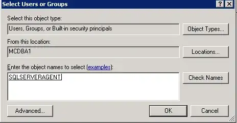

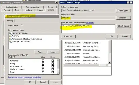

To specifically answer your question, here's how you give disk access rights to the built in SQL Server Agent account. But read on as I answer what I believe to be the real issue:
1.> Right-click your drive, select properties, select security, click the Add button and enter the SQLSERVERAGENT account(make sure your domain isn't selected in the From this location text box, but rather your computer name):
2.> Click the Check Names button to validate that the account is valid:
3.> Now, add the file permission you need to the SQLSERVERAGENT account. For trouble-shooting purposes, you may want to give Full control and then scale it back later as needed:

    My SQL Server Agent account was set to NT Service\SQLAgent$MyInstanceName and trying to set security on a folder and pressing Check Names said Name Not Found and wouldn't find it. After much frustration I realised that the default 'From This Location' when pressing Add to add permissions wasn't set to my local machine, it was set to my domain. Changing it to my local machine (the very root node in the tree) allowed it to detect my NT Service\SQLAgent$MyInstanceName account to add it to the folder permissions. – NibblyPig Oct 09 '18 at 14:47

I agree frustrating.. apparently it's as simple as just typing the name. http://zarez.net/?p=3187
Summary: Type NT SERVICE\MSSQLSERVER and then don't click check name just hit OK and you are able to set folder permissions for SQL agent account.
