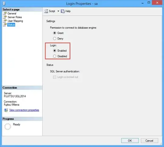

What you can do is disable the "sa" login
However, I suggest you check who has the "sa" login privileges and whether these are the right persons. A monitoring tool can be an answer, as it will show you everything that the "sa" login did on your instance.
Milena Petrovic
