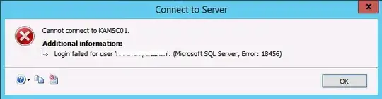

Immediately after the installer completed, I launched SMSS and am greeted by this error when attempting to connect.

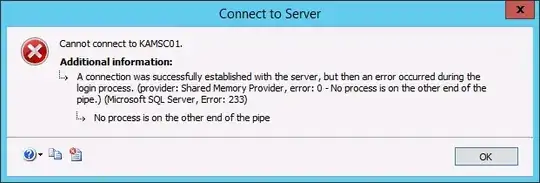

After clicking okay and then pressing "Connect" a second time I get this dialog.

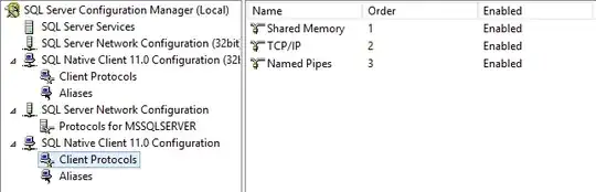

The TechNet article relating to this issue says to ensure that Named Pipes is behind TCP/IP in the protocol order, which it is.

  • Open the ERRORLOG file with notepad (you'll have to search your system for ERRORLOG files with no extension) and see what state is associated with the 18456 error. You can see a mapping here. https://sqlblog.org/2020/07/28/troubleshooting-error-18456 – Aaron Bertrand Apr 28 '14 at 18:57

  • @Kenneth it looks from the Configuration Manager screen shot that it is a default instance. We can't tell from there whether it's actually running, but the Login failed error means it must be. – Aaron Bertrand Apr 28 '14 at 18:59
  • @AaronBertrand Duh, I missed the Network Config entry. And your right of course. If he get's a login error it has to be up. – Kenneth Fisher Apr 28 '14 at 19:02
  • Also, when you installed SQL Server, did you add this login to the list of the instance's administrators? This is an extra step not covered by merely selecting Windows Auth during setup (though it is on the same screen). – Aaron Bertrand Apr 28 '14 at 19:04
  • Aaron, yes. There is an AD group that was specified as being instance administrators and the account I'm attempting to login with belongs to that group as well as Domain Admins – rws907 Apr 28 '14 at 19:14
  • Well, seeing the state will help, but it might have been better to specify an explicit user as well, rather than just an AD group. – Aaron Bertrand Apr 28 '14 at 19:18
  • http://dba.stackexchange.com/a/49767/1186 – Aaron Bertrand Apr 28 '14 at 19:20
  • I'm finding that out as I dig deeper. It didn't throw an error at all but I am about to go in and run EXEC sp_addsrvrolemember 'domain\username', 'sysadmin'; GO to see if that helps – rws907 Apr 28 '14 at 19:43
Yup, that last little comment was it. Even though you can select a domain group for the Instance administrators, it will create this problem. You must add individual user accounts. Thanks for the help and pointers!
