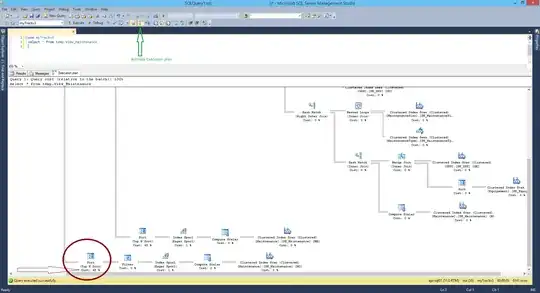

Usually it's a missing index causing this kind of issue.
What I usually do is running the query using the SQL Management Studio and enabling 'Include Actual Execution Plan (CTRL+M)' and find out which join is having the biggest percentage.
The application doesn't focus on the bottleneck, but you can find it "quickly" just looking into the result.
example here: 48PercentForTop
