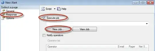

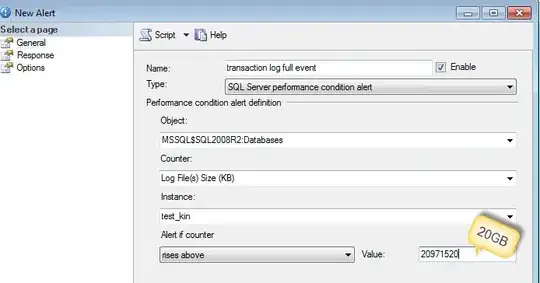

Best thing to do is to collect what caused the log file to grow by setting up an alert.
You can use sp_whoisactive to run and log into the table (as DennisT suggested) or dmv's like sys.dm_tran_active_transactions and sys.dm_tran_database_transactions
